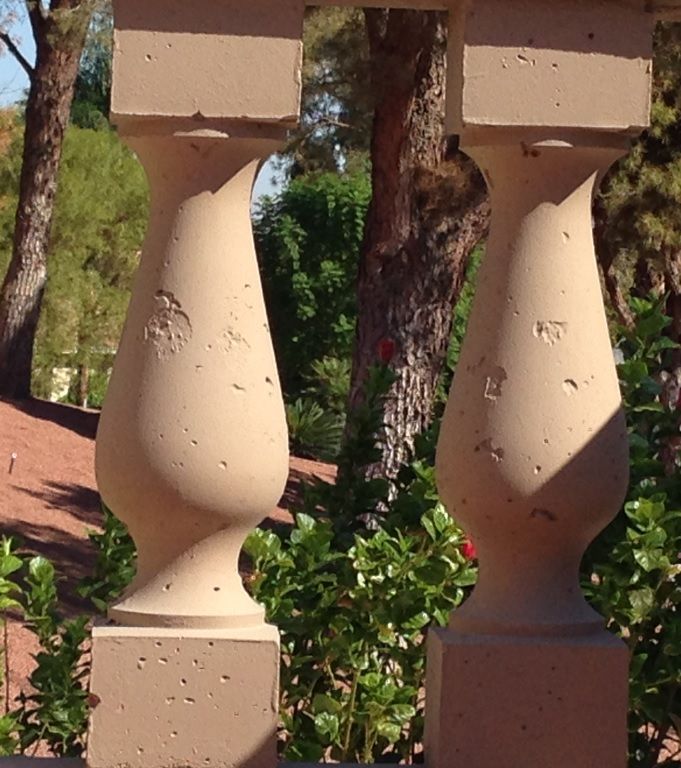

Need to rotate a profile?
Do I need to use a different tool to do this?
14 Replies 14

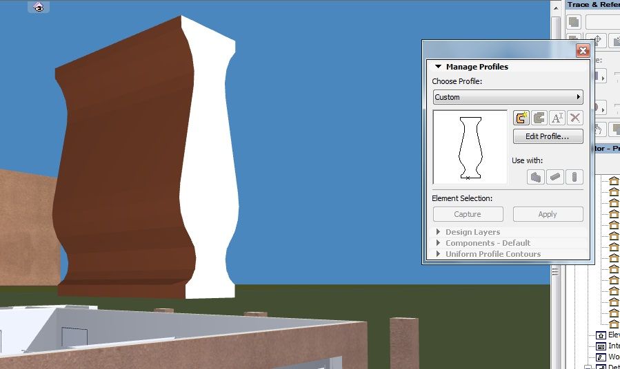

Can't seem to get it to rotate. it's coming in as an extrusion?
Got it, Sorry.
Hope I can increase the resolution of this...?
Eduardo Rolon
Use the Shell Tool instead of Custom Profiles.
Eduardo Rolón AIA NCARB
AC29 US/INT -> AC08
Karl Ottenstein
Moderator Emeritus
Jonathan wrote:
Got it, Sorry.
Generally, you won't want to increase the resolution - as I assume these will be multiplied and thus you'll multiple a higher polygon count element. If it were to be cut and detailed at a large scale, then sure.. the edges would look terrible. In this case, convert the result to a Morph, hide/smooth the morph edges, and it'll look plenty good. Then multiply the resulting morph element.
Glad you figured out how to revolve. The main issue with your original profile is that it was a full cross-section. To rotate, you want half of the profile ... a cut from the center of rotation out. You can then rotate using he wall tool, the Morph tool or as Eduardo suggests the Shell tool.

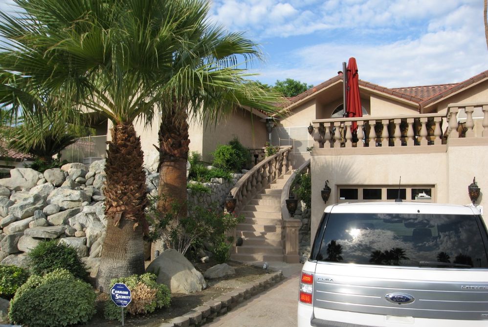

I think they are working good enough. Maybe convert to morph later if needed.
Tricky part will be to create enough morph bolders to do the fountain feature on the left and then the stairs..Ugh
It's a lot of rocks and bolders.
Karl Ottenstein
Moderator Emeritus
I think it would be easier to hire a front loader and a dump truck than to model that. 😉
But, see Barry's tip here:
http://archicad-talk.graphisoft.com/viewtopic.php?p=217585#217585
about converting cubes into Morphs to create boulder shapes.
That same thread has a link to a boulder object by Roberto Corona. If you have Cigraph ArchiSuite, it has a random rock object.
There are two random rocks from Cadimage on BIMComponents - a rough one and a smooth one:
https://bimcomponents.com/Search/rock
Looking at it further - I think I would model the mass as a mesh with a rock surface applied and use CineRender's displacement feature and call it close enough.
AC 29 USA and earlier   •   hardware key   •   macOS Tahoe 26.5.2 MacBook Pro M2 Max 12CPU/30GPU cores, 32GB
I know! I'm not looking forward to doing it, but if it works out it should look great and maybe be worth the effort.
I'v used the rots before and they are a bit strange. I spent a long time aranging those once and remember seeing them move around on their own out of the corner of my eye when the plan view would splash. Don't trust those rots anymore:-) See attached example of the rots.
I'll check out Barry's tip, thanks.
If I can make ten or twenty rock / bolder morphs of varying sizes it shouldn't be too hard to get them in there....
