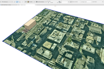

What our office has been doing is using a new surface with the Google maps aerial view saved to it, and then just having a mesh or slab (if a flat site) with that newly created image surface as its top surface.

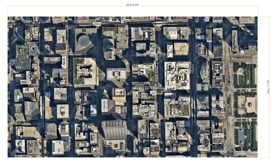

First I bring the image I want to use into the plan to scale it up to a fairly accurate size, assuming I can figure out something to use for scaling.
Here is an example
Once scaled up, I know what the extents of the the "end goal" surface are.

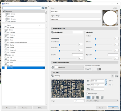

So, adding the image to your project library( or simply embedded library), create a new surface and add that image to the texture, adjusting the scale to the dimensions that match.
Then I draw a mesh or slab that same footprint, and override the top surface to this newly created one.  Usually I have to go into creative imaging and Align the texture to pick the correct origin.
so that "tan cube" would be the actual model for whatever the project may be, but has some real world context for when you are spinning around in 3d.
Probably several other ways to accomplish, but this is roughly an example of the method I have used for a few of the last projects that have required some site context.

Thank you Jeff and Eduardo and Hmooslechner (below). I can now add the picture to my 3D view but I have a new problem. While the surface I created is the exact size of the picture seen in the floor plan view which is the same size as the slab I created the problem I have is that AC wants to locate the surface starting in the middle of the slab and as such it "tiles" the surface. The result is that  top half the surface is on the bottom and the bottom half is on the top.; Unfortunately there isn't any ability within the "surfaces" control panel to allow the user to set the picture origin or even rotate the picture so that it aligns with the slab, in my case. What I need is a way to move the surface so that it aligns with the object (slab). Is there something in AC that allows the user to set a reference point and rotate the surface to match the object. The mirror settings in the "surfaces" control box don't seem very useful. Anyway, I got what I want but not exactly. Any assistance here would be appreciated.  Again thanks and regards.
With your slab or mesh selected in 3D, under Document-> Creative Imaging-> Align 3D texture you should be able to select SET ORIGIN.
If you are scaling 1:1, you should be able to select any of the corners and it should adjust.
if you have a rotation issue, you would just have to play around with the SET DIRECTION tab that can be found under the same Creative Imaging tab.
