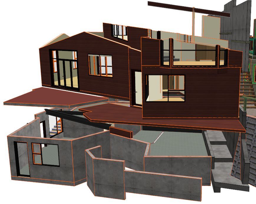

If I hotlink a MOD file into a project, and the multi-story source project has different story heights than the host project, all the elements of each story in the MOD file get positioned at the wrong elevations. See attachment for how this looks: there's a positive offset between the ground floor and first floor, a negative offset between first and second floor, and the roof is too low (FYI, the roof is turned off, and there's an SEO to trim the walls)
The adopted elevation of each element of the MOD appears to be assumed relative to the elevation of the corresponding home story in the host project, not it's own "original" home story in the MOD.
This seems really dumb of AC. Too dumb. Surely there's a different way of bringing in a model of a neighbouring project that has different story heights, that doesn't mess up the model. What knowledge am I missing?

Yes, this is an unfortunate limitation.
To link whole buildings (or multi-story modules) the story elevations have to match. When the heights don't match you have to link the building floor by floor ("single story mode" in the dialog). Then you can drag the floors up and down to their correct heights.
A problem with this approach is that SEO's between elements on different stories will not convey. To get around this you can either make all the SEOs betweens elements on the same stories or redo the SEOs in the destination file.

I've just been through the process of creating separate hotlinks for each storey. Here's a few more tips:
1) You don't have to export separate mod files for each storey - just separate hotlinks to one chosen storey located in the one multi-storey MOD file. This makes updating easier, as you only have to export one MOD file from the source PLN.
2) There's really only one way to handle SEOs: You have to make the operator and target belong to the same storey in the source file. The alternative suggestion - that you "re-do" them in the target file - lasts only as long as a session. If you do it that way, next time you open the project, your SEOs will be reset/gone. Hence, I've now re-assigned my roofs' home storeys to be the same as the walls that they trim, and set them to show on 1 storey above only (Choose "Custom" and tick off the " Home Story"option).
