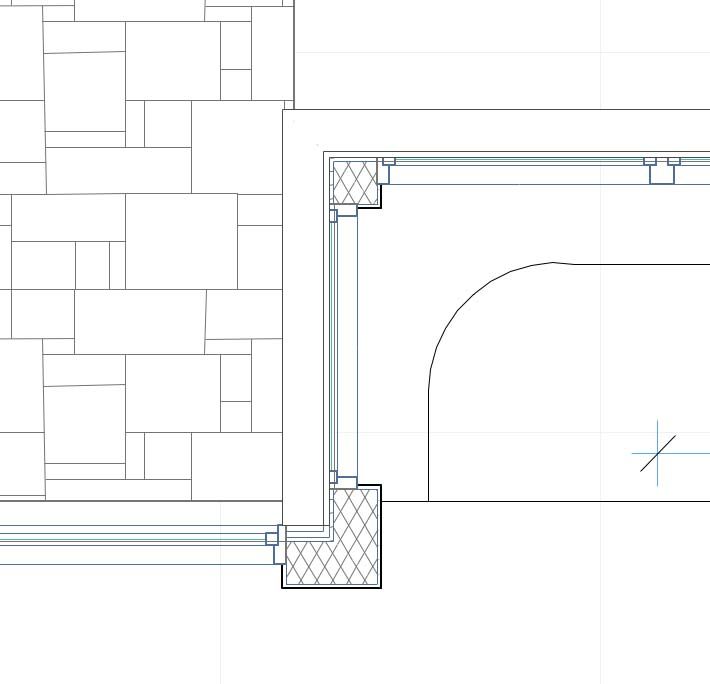

I am trying to create a wall with a Stone skin and sill below the window and siding above the sill (when there is no window). I used a composite wall (1/2"gwb, 5 1/2" studs, 1/2" sheathing, 3/4" air space, 3/4" siding) as the full wall and then applied the complex profile of a stone skin with sill (1"air space, 3 1/2" stone, sill on top). I lined up the inside face of the sill to the inside face of the siding so that SEO would cut the siding leaving the air space. Not perfect but reasonable in section. The problem is that in plan it appears to cut off the siding and the ends of the windows which are flush with the siding. I have tried the different projection setting but to no avail. I was hoping that material priorities would cut automatically but it didnt work so SEO was what I did. Any thoughts on the projection of the sill taking over the wall? Thanks.

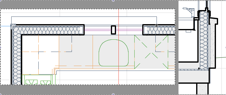

Section View doesn't show the window like in the plan as I removed it to see if it changed anything. Siding is cut off as well without window. Extra copy of skin is for reference to show what I used.
Any ideas? I still haven't identified why the complex profile is dominating the composite wall. I have tried different settings in plan view and am stumped. I suppose I could make a complete complex profile of the whole assembly but I liked the ability to add the stone skin with the right sill level as it has a variable height setting in the complex profile. It also keeps the main wall as a complete element. I am sure there are Archicad experts out there who can tell me I am approaching it the wrong way. I am still willing to learn!!

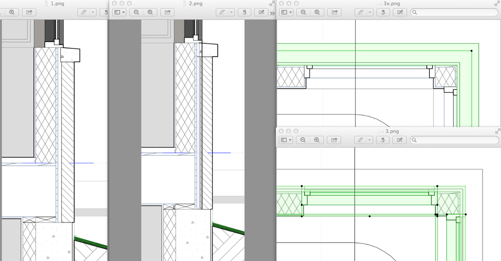

I have tried to compile some info on my obviously flawed setup.
CW-Composite wall:1/2" gwb|2"x6" studs|1/2" ply|3/4" air space|3/4" siding|reference line inside core
CP-Complex Profile:1" air space|3 1/2" stone|limestone sill at top (variable height)|reference line edge of fdn wall
Image 1 - Walls after SEO in section - looks fine.
SEO steps:
1. Floor(op)-CW(tar)-Subtract downwards (cleans up below slab as wall extends to top of fdn wall - keeps sheathing continuous to fdn wall)
2. CW (tar)-CP(op)-Subtract (cleans up siding, merges air space)
Image 2 - Walls before SEO to show overlapping elements.
Image 3 - Plan view showing CW and windows selected
Image 3x - Plan view showing CP selected
Image 4 - Plan view as generated showing window and siding cut off
Image 5 - settings of CP
Image 6 - settings of CW
Image 7 - model view options
Thanks for your help.

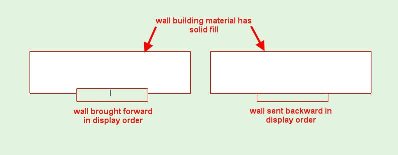

You can use the display order to bring the 2D display of one wall in front of the other but that will only work if your walls have solid fills (or at least the one that is covering the others must be solid).
If they are transparent (or semi-transparent) you will always see the other walls throught them regardless of the display order.
If you don't want to see the lower wall at all then set its floor plan display to 'Cut only' - but I don't think that is what you are trying to do.
