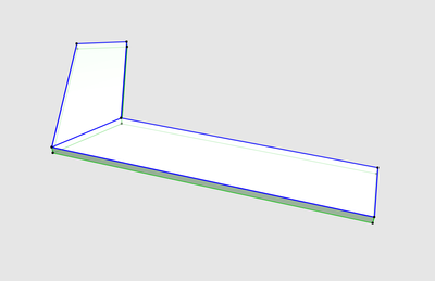

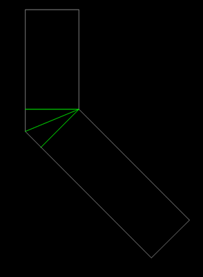

LeeJaeYoung
Please tell me how to make a ramp like this.
I can't make the connection part accurately. ^^
The problem is that it is difficult to process the green line part.

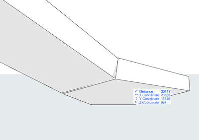

DGSketcher
Legend
Try making it with roofs and use Intersect Single-plane Roofs.
If that doesn't solve it then you will need to place a flat transition where the roofs meet to turn the corner. That is the only way to eliminate the twist where the beams are meeting in your picture.

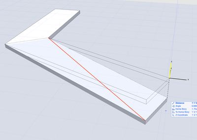

Eduardo Rolon

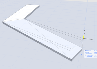

Yes, either.
Another option is to use 2 Slabs.
Convert to Morph
select the vertical planes
move them up (or down) in 3D Window
But I think that per IBC Code that corner needs to be flat and ADA compatible so all these suggestions are moot.

DGSketcher
Legend
You should also note that in @Eduardo Rolon image, there is a new line in the ramp (red). This tells you that the 4 points forming the slab are no longer on a single plane and the top face needs to be formed by two triangles. This could be a problem for your finishes.
