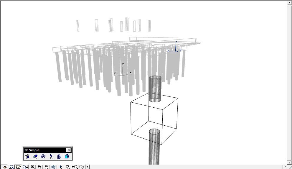

Hello there. This is my first post after some self taught archicad sessions.
I have modelled the foundation structure of a project where I have underground piles held together by pads.
What you see in the picture is the pile's intersection with the pad. Pad & pile have different material priority so when I produce a scheme I get the correct net volume of the pad (i.e pad volume - intersecting piloti volume). However, the visualisation is wrong: the piloti is subtracted by the pad and not the other way round.
I have also encountered this behaviour with other elements. Note that the pads are modelled with the slab tool, but this behaviour also shows up if I convert them to forms.
Any ideas?

Thanks Barry. The priorities are setup correctly. As I said, I get the correct deduction in volume - according to the priorities setup - but the visualization is wrong. This has happened with other elements, mainly those modelled with the slab tool.
I'm currently using the educational version, if that may influence the outcome of it...

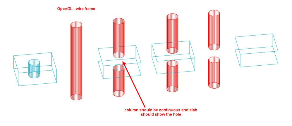

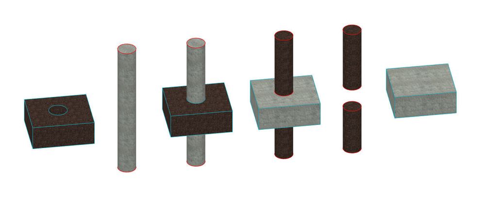

I think it is working properly.
If you select just your pad and view in in 3D (shaded view not wire frame) you should see the column holes.
And if you select just the columns you should find they are not being cut.
More examples to follow.
undefined
If you are looking at your 3D window in OpenGL with wire frame mode it will appear incorrect.
I think this is what you were showing.
My original images were done by making the pad layer wireframe and not the whole 3D window.
This is the same 3D in OpenGL with wireframe on.

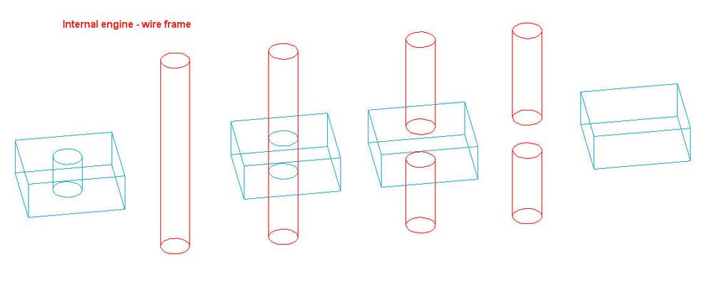

Oddly if you switch to the Internal engine in 3D with wireframe still it all looks correct.
Maybe a bug with OpenGL wireframe?
