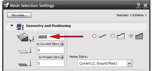

I have some troubles to drop the land's height, i put in the details of my land, around 173000 in height,
Wat i did is, i go to 'view'--> 'element 3d view'--> 3d cutting place' draw a line trough the land, then activate '3d cut way'. I can see the height of my land is dropped in 'Generic perspective' but not in the 'elevations'. what steps am i missing?

You don't really need your land model to extend all the way to sea level do you? Why not just model the part near the surface? I find anywhere from 3-10m below the lowest point is generally enough.
The 3D cutting planes only affect the 3D window and views derived from that. Section/elevations are separate and each have a setting for top and bottom of the section cut.

Matthew is quite right you can simply insert a negative number in the dialog box (see picture) this will chop off some of the bottom.
If the land mesh is placed on the same storey as your floor slab you should position it's height releative so to place the SL=0 of the mesh at 0.
In your case if your storey is set to match a floor slab at 173m. The mesh should be placed at -173000 and you could put -150000 in the box I mentioned. This would place the mesh in the correct relative position with the bottom 150m missing.

This is a neat trick also but not quite what I meant. If you set one of the two reference levels to sea level (relative to project zero - see attached) then you can simply adjust the mesh elevations relative to that reference level.
This saves having to do the somewhat counterintuitive negative thickness and eliminates the need for a sea level story height. In fact it separates the whole issue from story settings altogether.
