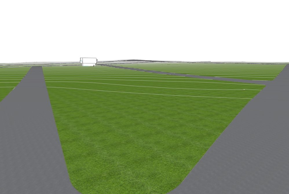

I just started a project on which I have to design approximately 30 buildings on it. Thing is, the terrain has a slope and the buildings on it are different and don't have the same story settings. Even if they did have the same story settings, the variation of the terrain means that, for example, Ground store of the building in the lowest part of the terrain will not match nor appear as the one on the upper part of the terrain.  How do I fix this? Is there a concrete way of solving this. I looked up some help and some suggest using hotlinks but I'm not sure I understand the process very well and it seems like it is a lengthy and a complicated process, especially when you want to make changes on certain buildings.
So, my two problems are:
a) Having buildings on the same file with different story settings and
b) making sure that the "x" floor will appear on all the buildings taking into consideration the slopery terrain.
I would greatly appreciate any help or a concrete way of dealing with this problem.

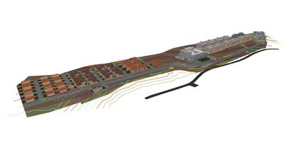

As there ae various possibilities depending what exactly you are looking for at present as end product. You can use modules but then have to be careful about story levels, can convert the prototype building into GDL Object but do have some pros n cons of that too. As i have worked on the site which carries almost 23meter drop where I have to place almost 20-25 various buildings,  I can guide you for sure but have to understand your need in better manner.

1. Overall design of the buildings is relatively similar but not necesserily. The bottom part of the terrain consists of buildings with "almost the same design", but they do slightly vary in size between each other due to the plot they're located on (bigger plot of land-bigger dimensions/fulfilling allowed construction coefficient). The upper part of the terrain consists of primarily 6-story tall buildings. (Terrain and overall project seems quite similar from the picture you shared)

To re-emphasize, I want to know if there's a way to show the same Story across the whole project on all the buildings simultaneously, for example, I want the ground floor of the building in the most upper part of the terrain to be visible while the building on the lowest part of the terrain to also show the ground floor, then same for the next story and so on. So basically just clicking on a story level and have all the buildings show up that story and not have the stories mixed up due to the terrain.
 If there's not a way to do this, I would appreciate knowing how you would approach this  project since you seem to have had the experience on dealing with this situation. Any tips on how to deal with, or maybe just sharing the process you dealt with the project you shared in the picture above would be helpful.
