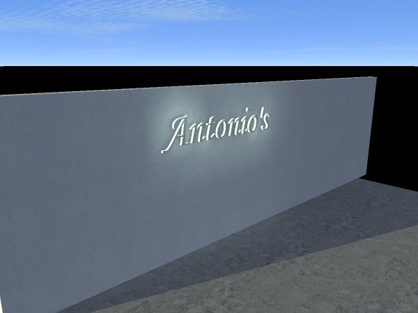

Played a little more - time to get back to work. Artlantis is pretty fussy about neon, perhaps because of its auto-exposure feature. I had to use very low power at night to get a softer glow, but then had to use 10 times the power in this later afternoon shot to get any glow at all to show.
Cheers,
Karl

Dwight
Almost like in real life where the sun trumps everything!
It seems in Artlantis that as soon as the heliodon is activated, the power of other lights diminishes.
Here is a similar light that is also suppressed.

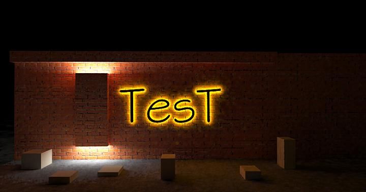

my quick try . . .
ofc, this is not artlanits
no faking !
i have problem with my moitor its not calibrated so image can be display wrong at your monitors !
low quality image !
undefined

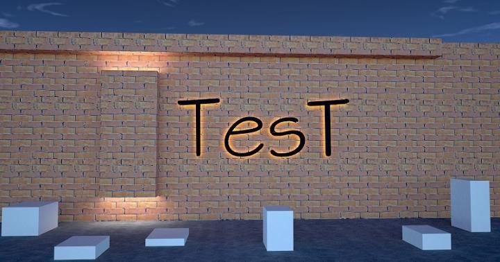

2 image
undefined
Dwight
Wonderful!
The usual problem with this effect is that the light is too strong.
How do you contain the light?
Here is a neon solution in LightWorks that could be a backlite, too.
