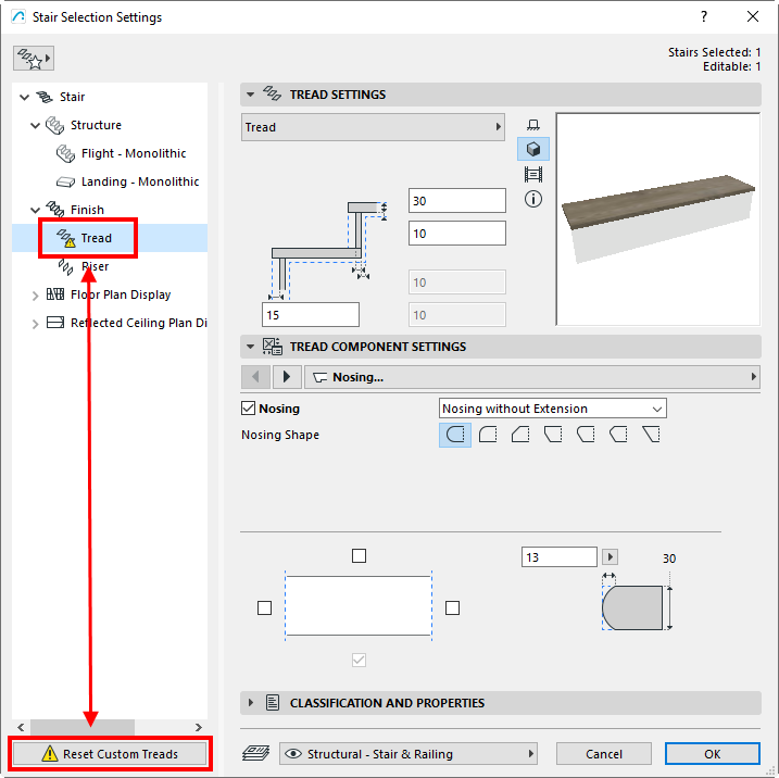

If you edit the settings of individual Treads/Riser, you will get a yellow Warning icon in the Stair Dialog. Also, a "Reset Custom Treads/Risers" button will appear in the bottom left corner of the Dialog, using which you can undo those changes so all Treads/Riser will have the same settings.

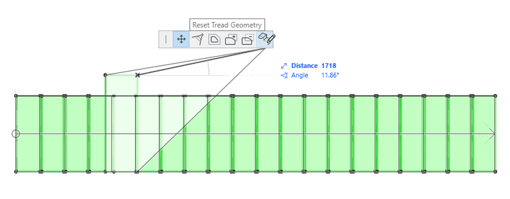

You may also modify the geometry (polygon of Treads or polyline of Risers) of individual Treads/Risers. In that case, you can select a modified Tread/Riser, and use the Pet Palette to Reset the Tread/Riser Geometry.

Somehow, though, the Reset Custom Threads option in the stair dialog didn't show up, but I used the pet palette button.

I think the Reset Custom Treads/Risers button appears only when you go to Edit Mode, select one or more Treads/Risers, modify some setting just for those Treads/Risers (for example, changing the thickness of the Tread), and then click OK. So, you are not editing their geometry using the Pet Palette, you are changing settings in the Settings Dialog/Info Box. Then the warning icon and the button will appear the next time you go to the Stair Settings Dialog.
