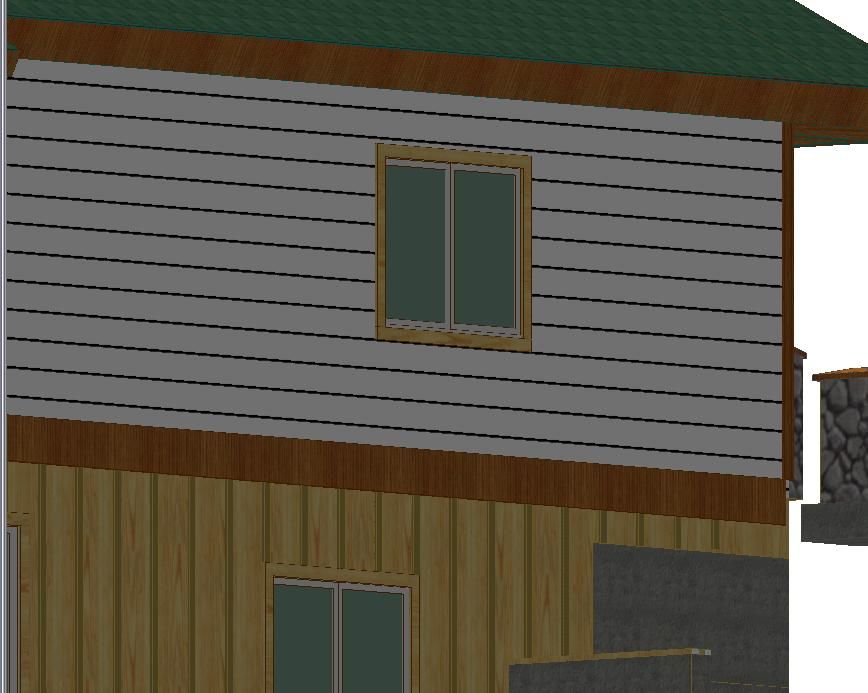

is a horizontal Siding that has a white Background. How is this color changed. Or how can a Wood Colored Texture be produced?
See Attached (Note: Ive got Board-N-Bat to display with tip from Karl)

Jay:
Go to Options>Materials... and select the material you are using. Click on Edit Texture... and under Alpha Channel Effects check Surface (you can add other effects if you wish, but not Transparency). The color that you set under Preview in the Material's dialog box will now show where the texture is white. This color will only appear in the PhotoRendering window, not the 3D window.

Photoshop ... make a new texture image...

I have the same problem; don't have Adobe. I've opened the texture in Paint, which is in accesories in your Windows program. You can change the color there, then save it under a new name. Then make a new material with the new siding color.
It should show up in both photorender and 3d window. If you use the Lightworks in V9, you have to "preview" it with Lightworks before it will show up with that engine.
