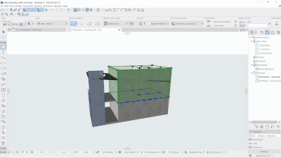

Smart roof editing in Archicad: When to crop, When to trim, When to use SEOs
Archicad provides various modeling features for precise building geometry adjustment. Let's see those which are for adjusting other elements to roofs/shells and for creating complex shapes using Boolean operations.
  • Crop to Single-plane Roof,
  • Trim Elements to Roof/Shell, and
  • Solid Element Operations (SEO).
Each targets specific workflows—static cropping, dynamic associative trimming, and complex Boolean operations—helping designers manage everything from roof detailing to advanced 3D intersections.
