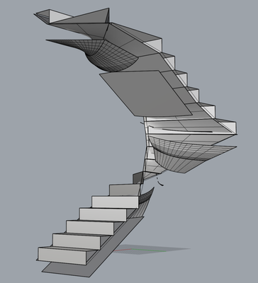

I've even tried to construct the staircase in Rhino but I don't know how to create the reinforced concrete part:
The OffsetSrf command breaks apart the polysurface that should be the upper surface from which the concrete part should measure the thickness. That's just my limited Rhino knowledge, unfortunately.

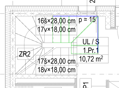

GG_rakurs
It looks like I have succeeded.
1) I separated the staircase after the first full turn and before the second.
2) I made the second part one step longer / higher than it needs to be because the winding end wasn't working properly.
3) I used the slab(s) to cut off the parts going above needed elevation.
4) I duplicated all the stairs. The doubles were used as structure + finish, while the originals only have finish. They are put in separate layers, and then the stairs with structure and finish were used as SEO subtraction target, and the ones with only finish were used as operator. By doing that, I will have clean stair representation when using filter "core of load-bearing elements only" because the stairs are still not properly done in that regard within normal ArchiCAD workflow - finish stays on them. It's a well known bug that persists throughout many versions.
4) I disabled the walking line / description in the model view options and manually added them.
5) For description, I used autotexts where possible and manual entries where needed.
Profit.
(Loss of too many working hours but what is done is done.)
Basement:
This staircase (Basement to ground floor) is in one piece. It just works. However, disabling things in MVO means I had to manually draw the arrow and provide description.
Ground floor:
The selected part shows where the cut-off was made.
First floor:
Again, selected part shows where the cut-off is.
For floor plan display, I use only the stairs in the structure layer because the other ones with only finish show two lines for every riser.
