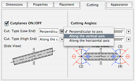

~/archiben wrote:Something for you to consider, should you take this quite promising concept further:
more likely one of the 'i's or 't's i forgot to dot or cross. that object was simply just a proof of concept. another 10/15 minutes with it would probably be needed to clean it up properly so that the beam/column functionality was correct.
1. The top & bottom should be able to be independently defined to be at least
a) horizontal
b) vertical
c) at an arbitrary angle against horizontal plane
d) at an arbitrary angle against the axis
2. Ideally the "angle" should be able to be defined interactively, in plan projection at least.
3. Even more ideally, the height should also be able to be defined interactively in a 3D view. (The column may support a beam that is not horizontal.)
These are either existing, planned or wish-listed features of my (admittedly less than ideal) VectorWorks object. (Item 3 is, I think, beyond either my programming skills or VectorScript programming language.)

1. The top & bottom should be able to be independently defined to be at leasthow is that any different from how the cutting angles are currently implemented? you can already do this with the cutting planes. or are you talking about tapering the column/beam?
a) horizontal
b) vertical
2. Ideally the "angle" should be able to be defined interactively, in plan projection at least.which angle? the inclination angle or the cutting angles? depending on the context some are editable, some aren't and others need to be.
for example, you can edit beam cut-angles interactively in plan, but not column inclination angles. and depending on the axis of the column cut-angles, they probably shouldn't be editable in plan because there is nothing to align them to. in other words you can't see what you are doing because of the 2D limitations.
regardless, this is about the only thing you've asked for that isn't quickly achievable. but a spot of GDL to provide a hotspot toggle in the symbol somewhere would also take care of that.
3. Even more ideally, the height should also be able to be defined interactively in a 3D view.the height/length - whatever you want to call it - is interactively editable in the 3D window: click hotspot, choose stretch from the pet palette and away you go.
