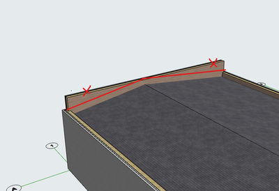

I would like to trim the walls as shown in the picture. I can't trim them to the roof as they  go further up than the roof.
Hope someone can help me to the right, and hopefully easy method. I am new to Archicad, but have experience from Revit.

Hi DGSketcher, I performed some tests in AC24 to see if I could edit in elevations like I said above.
Your right, AC doesn’t allow me to add a node in elevation on walls and even on slabs like it does with morphs in elevation mode hmmm ???
I can trim to roof though but after that the gable shape doesn’t stay in place when I peel back the gable end.

@mthd wrote:
Please see the “crop” method. Hopefully when we peel back the gable, the triangular top of the wall cut by the roof planes will stay in place ?
Yes, crop is a permanent crop, but you can 'undo' the crop to return the wall to its former state.
So to have the wall trimmed or cropped above the main roof, you will need to add a temporary roof in the position you want the trim/crop.
With crop, you can delete the temporary roof and the wall will remain cropped.
With trim or SEO you need to hide the temporary roof in a layer that you can turn off.
The roof must remain for the trim/SEO to remain in place, but the roof (or any other element you are using to cut with) can be hidden in a layer that is turned off.
Even with the crop I would be inclined to hide the temporary roof in a hidden layer, so you do not have to re-model a new roof if you want to adjust the crop.
But that is where the trim and SEO are better because they remain live to the position of the temporary roof.
Move the roof and the trim/SEO amends.
Trim will use the building material strengths to determine which skin cuts which skin.
Crop and SEO will simply cut the entire elements and not use building material strengths.

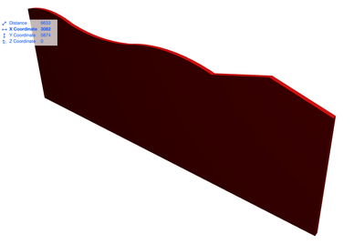

I'm surprised the Power users haven't described the easist method of shaping the wall top in elevation. Put an opening across the top of the wall and shape to your hearts content. Use it all the time. AC 25 onwards, no SEO in sight

Never even thought to do that. I guess it appears correctly in plan too as SEO's don't.

Whoa ! Sounds awesome BB.
I have to get my brain around it but I think putting a molding on top of the wall edge might also be easier as well now ? Particularly since architraves tend follow opening edges from what I know ?
Definitely need to hear more from power users.
Edit: I tested your method above in AC25 Demo and it works a treat.

I was going to suggest that, but you will have to play around with the floor plan display so you see the solid wall and not the opening.
I think 'Symbolic' or "overhead All' I think to see the solid wall and not the opening.
Also need to turn the plan symbol off.
I haven't explored all the settings yet so not sure if there may be others that need to be played with.
But yes, this is a good option too now - especially as you can have a polygonal shape opening now.
@Brett Brown Using the opening tool is a new & valid solution, but I am not yet convinced if it is any better for simple roofs. The problem I see is you are still managing a free floating & hidden cutting element. As @mthd suggested other software lets you modify the wall head which would be potentially a better solution to his problem. For me, I think the need to add a capping to the parapet sets the workflow logic to using a beam with SEO imho.
