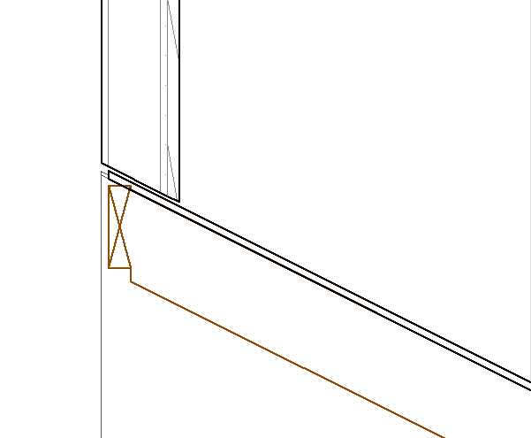

Peter wrote:
To get a seamless joint in section, the cut fills need to be the same in both the slab and the wall.
To get a seamless joint in elevation, the materials applied to the surfaces need to be the same.
Does this only apply to slabs and walls?
For instance, in the attached picture, the cut fills for the member with the x in it is different than the rafter to which it's attached yet there's no line showing separation between the two.
