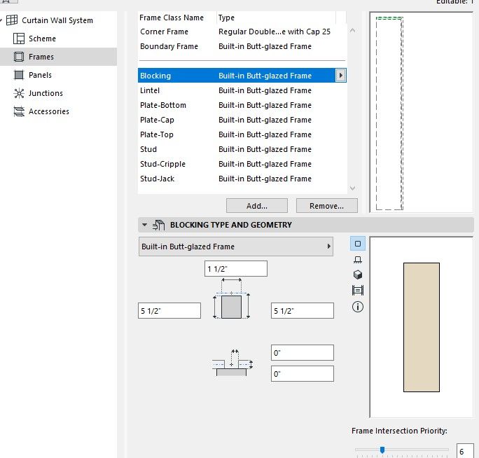

When using curtain wall for wall framing, it works really well when creating separate frame classes for each member type (I've got blocking, lintel/header, bottom plates, top plates, cap plates, studs, cripple studs, jack studs). Careful control of the intersection priorities of each class makes for very clean intersections. I was having a bit of trouble with lintels, so the one in the image is actually a separate beam.

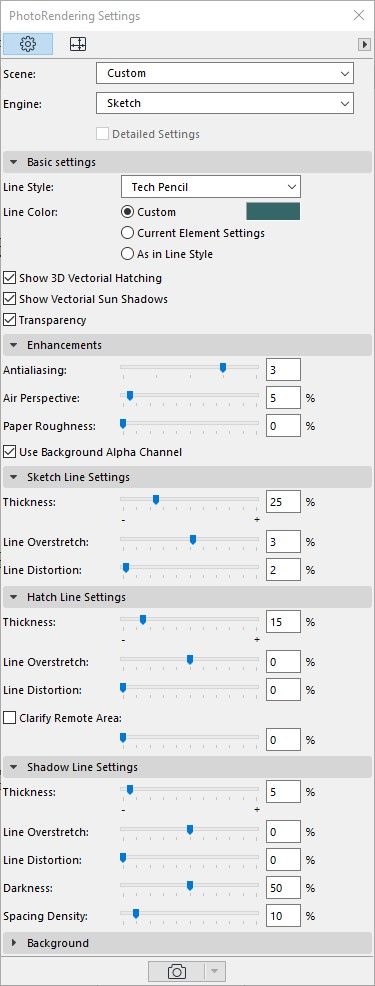

Thanks Eric. Attached are the settings that I use for my sketch renderings. Here, I'm using a green pen (RGB: 52,103,103). I find this is less stark than using black. Though a dark grey or dark blue work well too (with lower saturation, in the 75-80 range)
On Windows 10, I use the Snip & Sketch tool to grab the screen shots (Snipping Tool in Windows 11). I think you use Mac though?

Thanks @Jere  - I used your screenshot to reproduce the Tech Pencil settings you're using. It works nicely. Thanks for posting the detailed info!
BTW yes I am on Mac and use Snagit as my screen capture tool most of the time.
