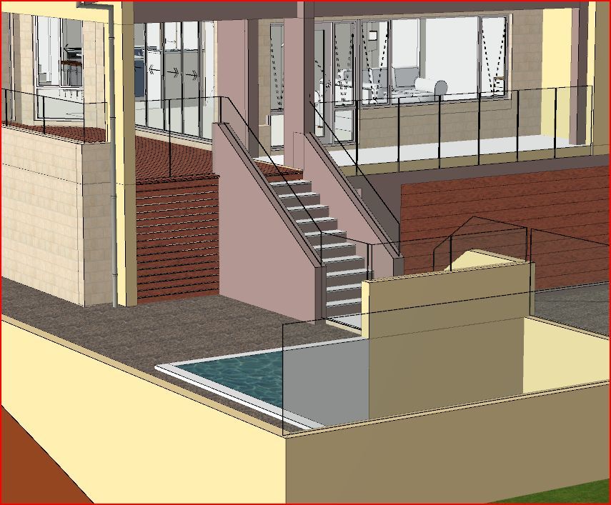

The attached screenshot shows that my glass balustrade with transparency enabled is for some reason 'blocking' the texture on my 'water' (just a slab object with water texture). This doesn't affect any documentation but it is a little annoying. Anyone know a quick fix?

what happens if you adjust the view just slightly? Did you try to regenerate?

As I rotate the view around the glass always is blocking only the portion of the texture it is in front of so it is not a regeneration issue. The only way I can fix the issue is to change the dsiplay of the layer the balustrading is on to wire frame.

As I glimpse, it seems to me that you have made the water in your pool from Thin slabs with the image of the bottom of a pool as material? Am I right?
I would have tried to change the upper slab (in the water of the pool) to plain water (or glass) and see what happens.
