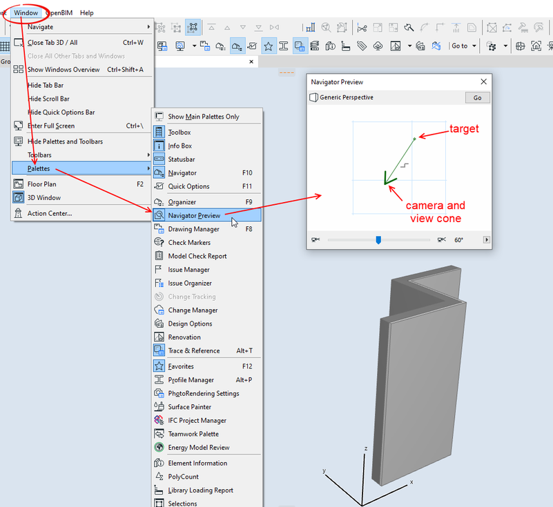

Your video shows you rotating with a perspective view.   This will all depend on where the virtual 'camera' is placed relative to your model.  If you turn on Navigator  Preview you'll be able to both see this camera and its view cone... and drag it to where you want it.
When you view in an Axonometric view (which is typically way more useful for 3D modeling - vs visualization) - the center of rotation is the center of the mass that you're viewing.  That mass can be everything, selected elements, or the elements contained in a thing (single story) or bold (multi story ) marquee.  The Project Preview will look different here vs Perspective and you can rotate around what is viewed there by dragging the camera too... as well as with mouse / keyboard controls.
You can probably do everything you're used to in other 3D programs... just have to get used to the way Archicad does it 🙂

Karl, interesting, thanks for sharing! What is Project Preview? The Archicad documentation says this is the preview image for the file systems, not related to cameras and orbiting. Maybe you're talking about the 3d Projection Settings? There I can see and move the camera I think.
For object very far away from origin just found out that in Perspective mode, if you select the object, then orbit you orbit around the object there which is nice. This does not work for Axonometry though.
Archicad v26, MacBook Pro, MacOS 13 Ventura, AMD Radeon Pro 5500M 8GB, RAM 64GB, Non-SSA, Twinmotion User
I think Karl means 'Navigator Preview'
ethanbodnar
Oh got it, thank you both!
