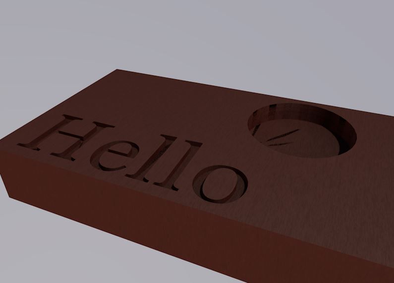

I am still having some trouble with the imprints/cut-outs.
When I insert the cylinder to the target piece it does remove that volume of material but I cannot see the inside surface of the removed area. The cut-out makes the grey slab appear wafer thin but it is actually 10mm deep as the front vertical surface shows. See attached image file to illustrate what I am trying to describe.
Any ideas where I am going wrong?
Thank you
Hi!
In the Solid Element Operation Dialog Make sure you have the option Use own attributes on, and not the other one.

Thank you again. That worked perfectly.
