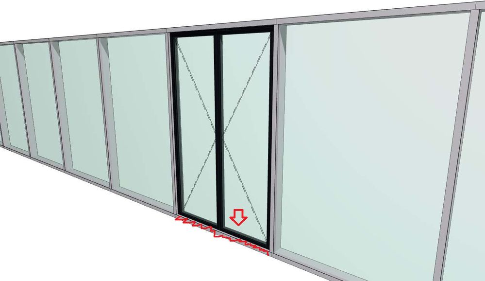

does anyone knows how to remove de boundary frame under an entrancedoor in a curtainwall??
and than if possible place the door at the same level as the boundary

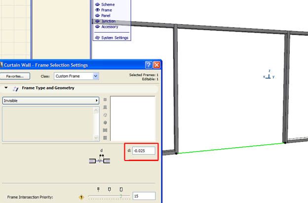

Making the lower frame invisible is the way to do it. To get the door panel to extend all the way down, select the invisible frame and change the 'panel slot dimension' (d) to a minus figure equal to half the width of the frame.
The priority of the vertical jambs will need to be increased to a figure greater than that of the boundary frames (usually set at 15) in order to get them to extend past.
