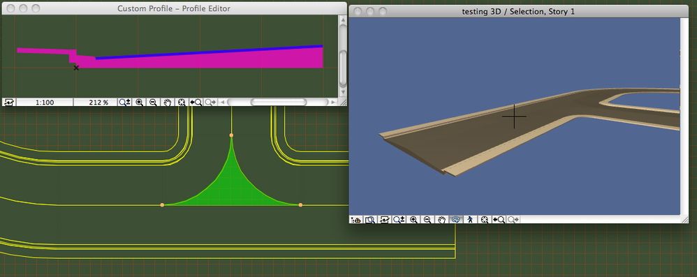

You could use walls/custom profiles/composites for making roads with curb, gutter, sidewalks, striping, all at one time.
This is what I achieved so far. I used composite wall structure. The problem resides in the filleted zone of the intersection, the street must intersect with fillet at a min. 4.00m not angular.
Currently I draw a sketch with the walls then I explode the walls in 2D elements, erase the fills and then manually do the fillets. Is there any method to take things further in order to automate the fillets?
Thanks
Do the sides of the roads using Profiled Walls and do the roads using Slabs.
You will not be able to achieve these results by modeling one road with one wall.
Dwight
The simplest way is, as Steve says, a custom profile for the sidewalk, curb, gutter, but create only one half of the roadway. You are then drawing each side of the road independently. This lets you crown the road.
When you come to an intersection, draw your corner radii. Viola!
There will be a void in the center. This part can be filled with a magic wanded slab.
Of course, no road is flat for very long, except in South Dakota. You'll need OBJECTIVE to create descending curves.
Also investigate ArchiTerra.
Dwight Atkinson
Dwight
And, of course, you can constrain the complex profile stretching to the roadway segment only for a horizontal stretch, keeping the sidewalk, curb and gutter undistorted.
