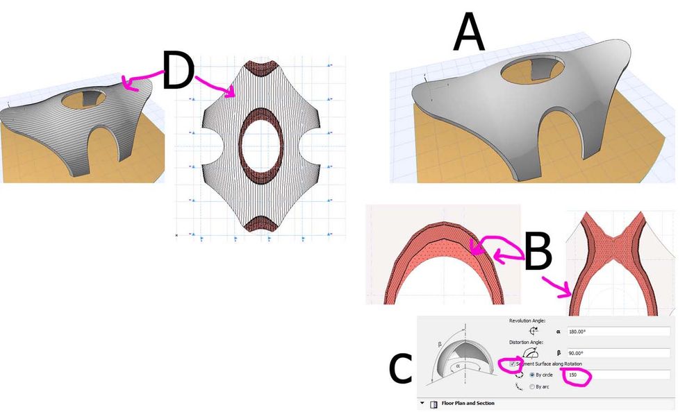

HI all : I have shell and it has good smooth in perspective -A- but in sections and plans it so bad -b- when I changed the segment to hight value -c- I get good smooth put a lot of lines in plane and perspective- d- ....
how can I get good smooth without increase the number of segment or with increase the number and hide that line .... thank you

If I'm not mistaken, the segment function is supposed to make segments that show lines. It's so you can make a facetted shape.
There is no control over how many segments curves make in elevations, but so fare I've never had any problems with the number of segments and the quality of the plotted/printed drawings. I guess it all depends on scale. We generally don't use the 3d model for anything larger than 1:50 scale in our office.
I think it is bad in any scale and I will draw 2d above it... thank

Also noticed this issue here and it is not only for the shell, curved stair slabs are another exemple...this has sadly not been fixed ( yet )
However, for the shell tool, You may look here for a solution:
http://archicad-talk.graphisoft.com/viewtopic.php?t=38490

thank you TMA_80
thank you it work but It need reopen AC
