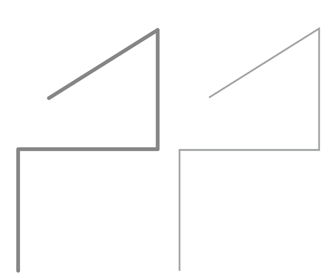

dans un deuxième temps, j'aimerais savoir s'il existe un moyen d'avoir un "angle pointu" comme Illustrator lorsque j'utilise une épaisseur de ligne réelle? j'ajoute une capture pour expliquer ce que je veux:

Secondly, I would like to know if there is a way to have a "sharp angle" like Illustrator when I use real lineweight? I add a capture to explain what I want:

On AC i've only rounded angleOn AC i've only rounded anglein illustrtaor i've "pointed" anglein illustrtaor i've "pointed" angle

Helle, there is no solution fot this, it's a defaut system setting

You can use very thin walls with zero line thickness and solid fill to draw sharp corners...

This is a very old wish that has been asked by many users in the past.
Why has Archicad not fixed this? Is there a particular reason it can't be done?

In my case I don't consider this a bug but you can make a wish so that they add a preference to choose that the corners have options like Illustrator.
