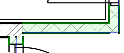

Hello, I have a problem with wall ends when I want to use thicker line weight. Even when I connect them they don't clear in a way a want them to. I tried to change the position of the reference line but it did't help. The other problem is that when I connect walls from different material and I use "end wall with line"  sometimes there is thin and sometimes there is thicker line as you can see on the two last pictures. I have been struggling with this issueThank you for your help.

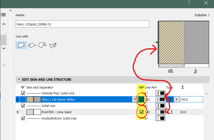

I have fixed the link.
This is an image of the setting you need to look at.

Could be that one of your materials is stronger than the core material.

In your wall composite settings, ensure the wall end lines are ticked.
Here is a post that will show you the dialogue.

Thank you, I can try that - will you just please send the link once more? This one is not working.
designrevellion
Thank you Barry, this fixed my problem also!
