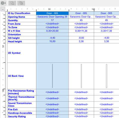

why can't I press select on floor plan in the schedule door
mrsneuna
why can't I press select on floor plan in the schedule door?I want to remove the opening from the door schedule
1 ACCEPTED SOLUTION
Solution
Eduardo Rolon
Question is not clear but if it has to do with the gray icons then that means that the layer for the wall where the door is inserted is either off, locked or in a hidden filter.

OK, everything has been solved, apparently the opening exceeds the story height
