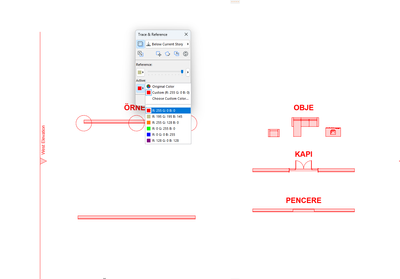

My entire project turned red while i was drawing check the attachemnt

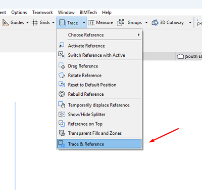

You have activated the trace reference function. Turn it off.

If you changed the color of the active elements to red in the trace reference palette, this may be the cause.
Or, in rare cases, this problem may be caused by the renovation filter. Try changing the renovation filter and restore it back.
