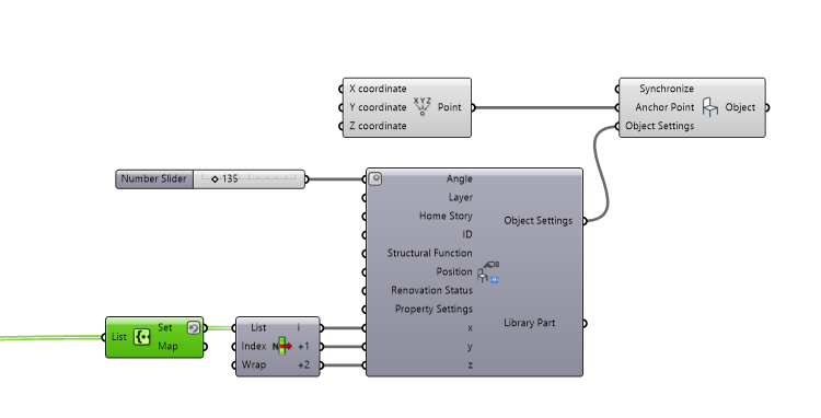

I know that here are a lot of expert GDL, I want to ask a simple question that I can not solve it..

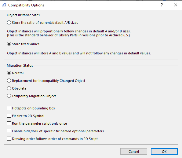

I only want to rotate the block (Archicad object) via the axis in the center of the block, but in AC always rotate that in the corner.
I have moved the hotspot but the same result, no change. I tried many ways but still got the same result, too difficult.
Can anyone give me some advice for that case? Thanks.
I attached some photos here.

Hi, maybe my response is a little overdue but it's also my first time posting here.
The hotspots command are used for visualizing them around the object, they don't make a change in the object's internal space
You need to move the object to the origin in the 3D script, the origin is sitting under one of your object's corners, so you will need to move it to the geometric center (let's assume for the moment you don't need to move it vertically), like this:
The command for moving an object in the 3d script is
ADD x, y ,z
If the object has a length of x, then the middle is x/2
If the object has a width of y, then the middle is y/2
As the object seems to be moved backwards, both values should be negative, then your script should be something like this
ADD -x/2, -y/2, 0
And your object should be in the origin, then you can figure how to locate
Best regards.
