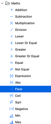

Use Floor to round down (1,5 will be  1) and Ceiling to round up (1,5  will be 2)

Ceiling did the job. Now it works as it is supposed to do so.
Thanks a lot. 🙂
