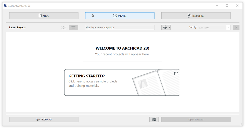

ARCHICAD 23 crashes right after clicking Browse… button in the new Startup Dialog. Though, in general, other buttons like New… or Teamwork… work well and all projects can be opened from the File Explorer by double-clicking on them.

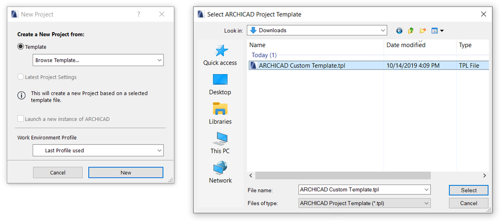

In some cases, accessing the content of a template file from a previous ARCHICAD version can fail. A template file is necessary for the Browse function to work. If accessing the template file is problematic the Browse function cannot continue and ARCHICAD crashes.
Re-save your template as an ARCHICAD 23 template file and make it the recent one as described below.
The defect causing this kind of crash has been fixed in ARCHICAD 23 Update 40xx.
As a good practice, you should use up to date templates. Up to date templates are important for migration processes and for performance and stability reasons.
