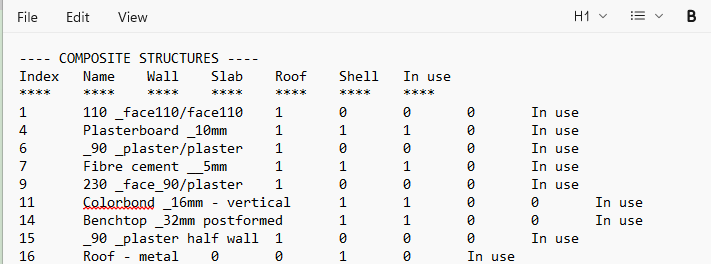

If you just need to know the index number for a composite you can print a list from the Attribute Manager.
It will list the index, name and if it is being used in the file.

The other option would be to export the text file like Barry suggested and you can then read that text file with GDL and extract information that way.
