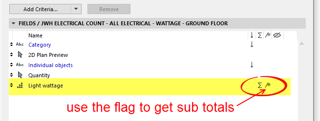

I thought scheduling had been updated to allow more calculations but if it has, I haven't found the secret sauce to do it in the schedule and not have to export to Excel.  I want to be able to group objects (in this example electrical outlets) so I know how many I need to purchase but I'd also like the total quantity to multiply by the individual cost to arrive at the total price for that row (i.e. all of them).  See:
Then If possible, I'd like to sum the column of row total costs to equal the cost for all materials and multiply that by the sales tax to arrive at the exact cost of all materials as I draw.
Is there a way to do this?
3 Replies 3
You can't do calculations between fields, but you can organise them to give a sum and grand total.
I don't have anything set up for cost, but I can calculate the wattage of my lights.
You would just substitute cost for my wattage, and you won't need the total column.
The trick is to use the flag icon to get subtotals.
That should be closer to what you want.
