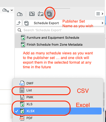

When you have many schedules that you want to export for use in external software, Publisher is more convenient as you can include in a publisher set every required schedule and one click will produce the output files.  This example has 2 schedules being published as Excel files:

Is there a reason you cannot just use Publisher?  You can publish in a variety of formats including numeric data file.
