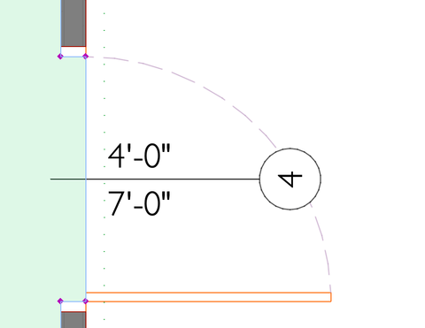

So @4hotshoes, we just had a similar issue which landed us at this forum. After a lot of troubleshooting and research, we found that there are a number of conditions that must be met for a door to associate with a zone. Graphisoft outlines them here. For us, the issue was that the zone on the "push" side of the door had been pulled across the threshold (see attached), meaning condition 1 of the zone being aligned with the edge of the wall had not been met. By trimming the zone to the wall on the push side of the door fixed this issue for us. Maybe this is your issue, maybe not, but we come across door/zone association issues every now and then, and I think the Graphisoft guide may be helpful.
