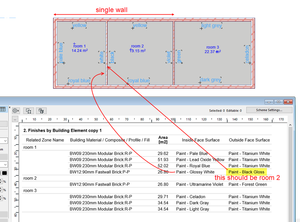

I just tried with a simple 'element' schedule and it seems to work for me.
Is this what you want?
Room with 4 walls all a different surface material.
The surface material schedule is even more refined I believe, as it can exclude surfaces that are covered (not exposed).
I have never had need to use it so have not investigated it.

Hi Barry, thank you for this suggestion. Although it would seem to initially work, very quickly you come across issues with the wall inside/outside surface parameter. Unless I am missing something, how will this work for zones on the other side of the wall which is designated as the Outside surface?
 I also do not need this information very often. But just very suprised: 1, that it is not easily available and 2. I need to know the special magic formula required to get it. I would think that in a BIM architectural program the interior surface area and volume for rooms/zones should be easily available.
thanks for your help

Yep, I agree it is not a simple as it seems.
A dividing wall is only recognised as belonging to one zone.
So doing a wall schedule as I have shown does not really work, because if a wall is picked up belonging to one zone, you can get the inside and outside surface of it.
But the outside surface really belongs to the next zone and it does not get recognised as such.
Similarly the inside surface of an external wall that spans two rooms (zones) will only be counted for one zone.
This is a 'surface' schedule with walls as the search criteria.
So it seems a wall schedule is not going to work.
We need a zone schedule that gets the wall surface the zone touches.
I wasn't sure it could be done but  think it can.

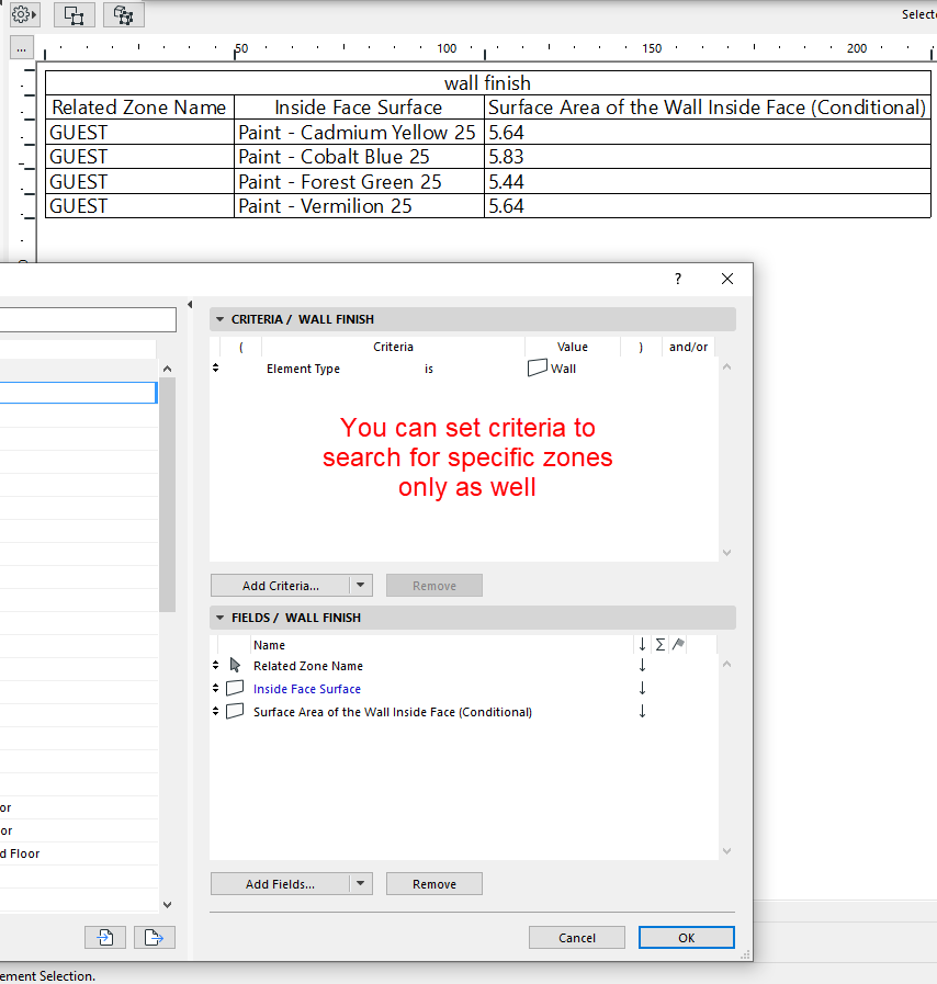

This is what I have so far.
A surface schedule with zones as the search criteria.
Add the fields you want - Exposed Area (by criteria) is what you want for the area.
But you must remove the criteria that would be deemed to cover the surface and reduce the surface area.
So make sure 'walls' are removed.
Leave 'slab' so the floor and ceiling area of the zone will be reduced when you model them - unless you want the wall and ceiling finishes as well.
I assume leaving doors and windows in will reduce the are by those objects (i haven't tested).
And the result (I have not modelled floor and ceiling slabs).
I hope this helps.
I forgot to say, make sure your zones are set to inherit the boundary wall surfaces.
