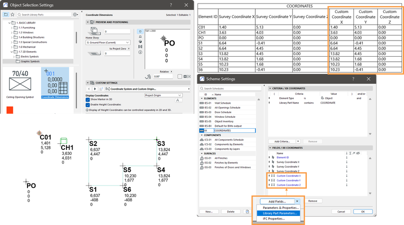

May be it is not what you have in mind, but there could be a workaround using the Coordinate Dimension object. You could place it wherever you need and create a schedule. You could select the desired origin and even create your customized one; if so then you will have to search the Custom Coordinates in the Library Part Parameters.
I hope it works for you.
Best regards.
M. Arch. Ricardo López
Thanks Ricardo.
Wouldn't this require inserting the object once for each element I need to report on?
Archicad 28.3.0 (6003) INT; macOS Sonoma
Good morning @alexliz
You can place the point where you need it and generate the list from those points you consider appropriate. It is not an automatic procedure unfortunately.
