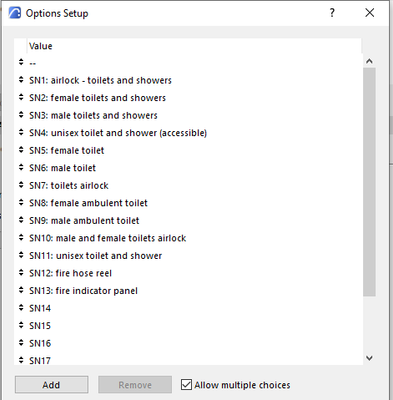

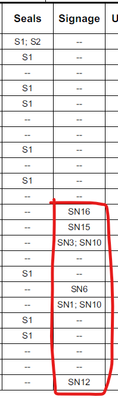

‎2024-04-06 12:43 AM
almost a year in for this post, but is there still no way for this to work with multiple choices allowed for the Options Setup?
for the first image below, we have set of signage codes that that we use for our door schedule. i'd like for our users to easily see what the code stand for, instead of having to jump between windows. it has the code (SN1, SN2...), a colon as delimeter, and the note at the end explaining the type of signage.
the second image below is what should appear in the door schedule
i'm testing this in 25, but we'll be moving to 27 soon.
