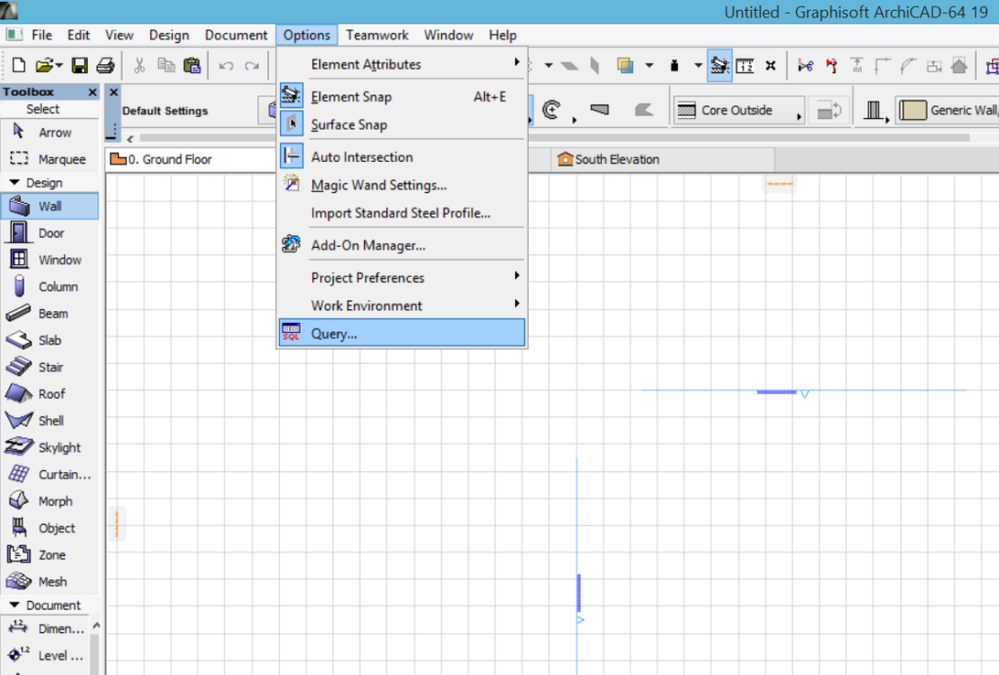

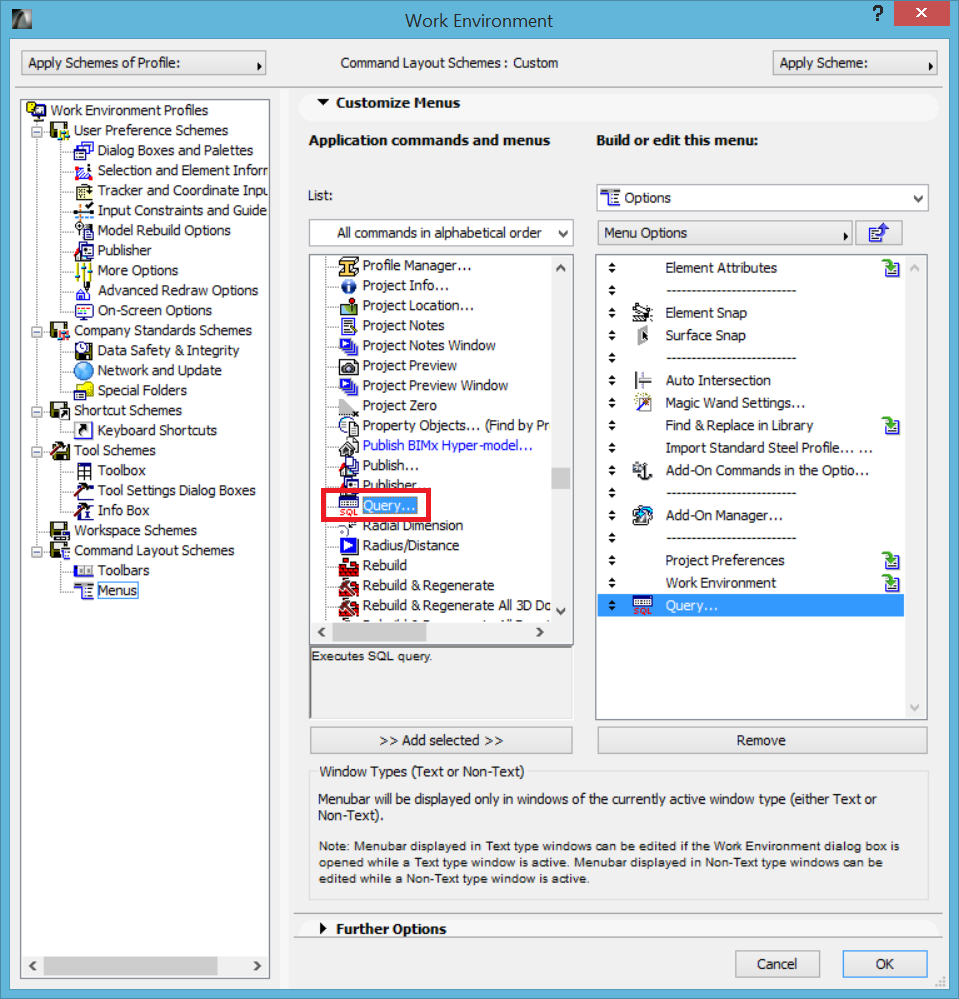

  • Go to Options - Work Environment and add Query (it is easy to find it in All commands in alphabetical order) to a chosen Menu option.

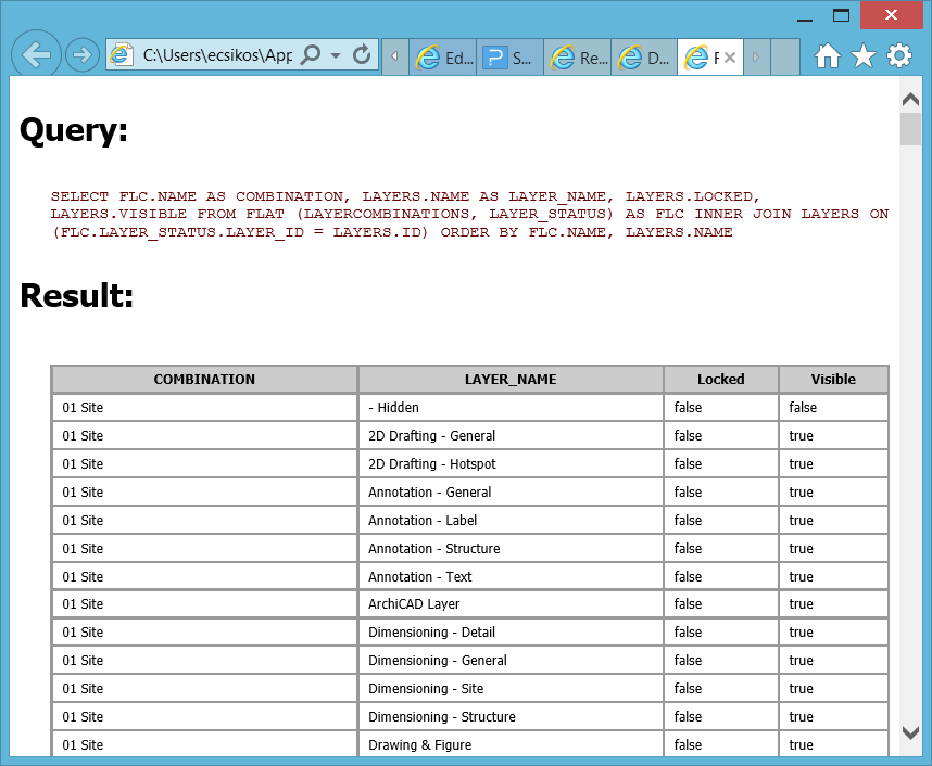

Choose Query... and paste in the following (below 'Type your SQL query here:'):
  • SELECT FLC.NAME AS COMBINATION, LAYERS.NAME AS LAYER_NAME, LAYERS.LOCKED, LAYERS.VISIBLE FROM FLAT (LAYERCOMBINATIONS, LAYER_STATUS) AS FLC INNER JOIN LAYERS ON (FLC.LAYER_STATUS.LAYER_ID = LAYERS.ID) ORDER BY FLC.NAME, LAYERS.NAME
  • Click the Execute button. The result will appear in your web browser as an alphabetized table. (see screenshot below)
    You can save the HTML and/or paste it into Excel, etc. for further manipulation to achieve your documentation goals.

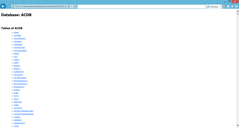

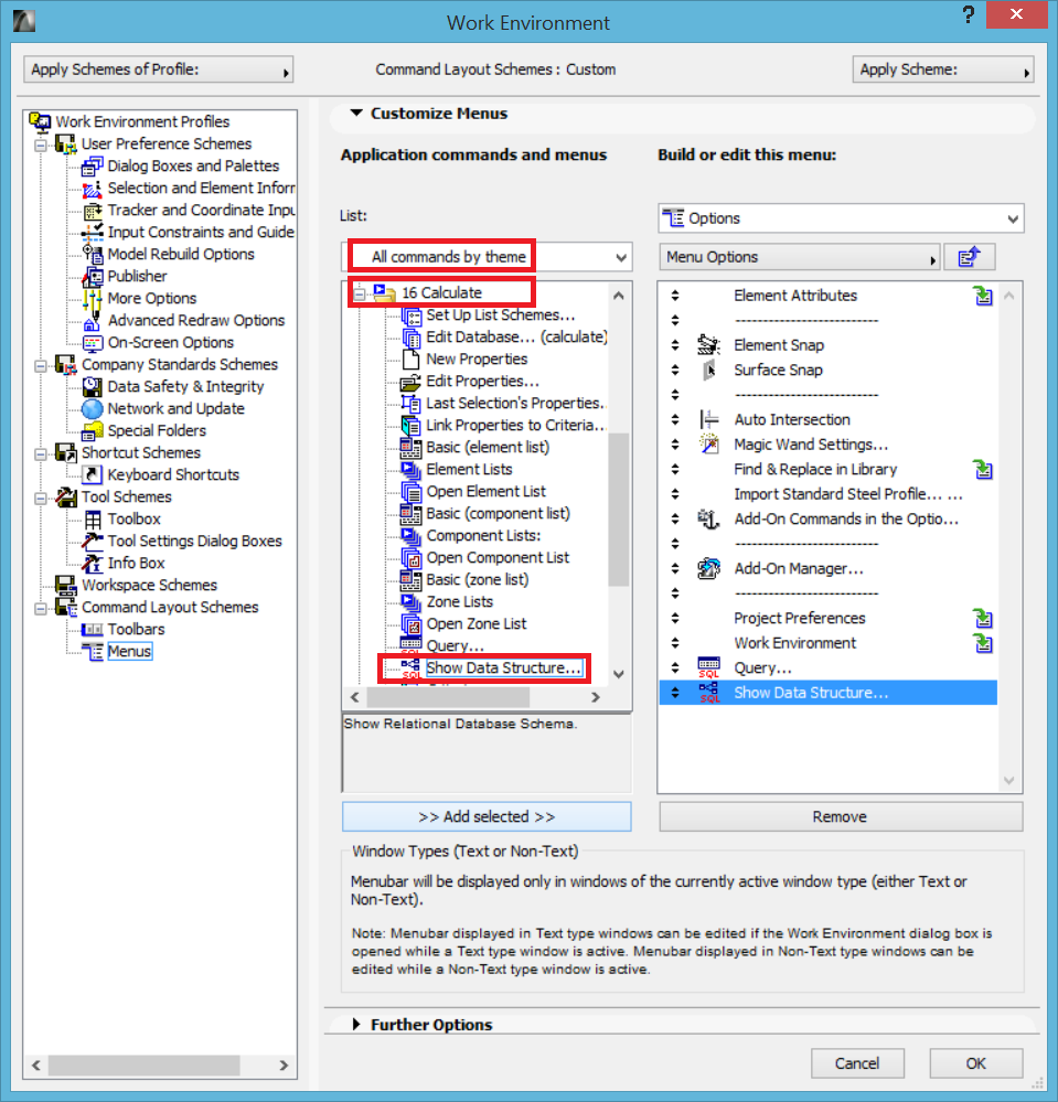

By using the command Show Data Structure you can display all of the tables and fields that can be viewed with SQL Query. Just like Query, Show Data Structure can not be found in any of the Menus by default. You can add it to one of your menus in Work Environment by using the sorting "All commands by theme":

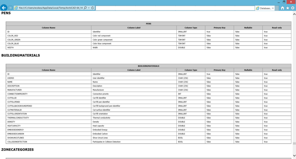

  Then, this command will open an XML file in your browser showing all of the fields and tables... that looks like this:
  and this:
