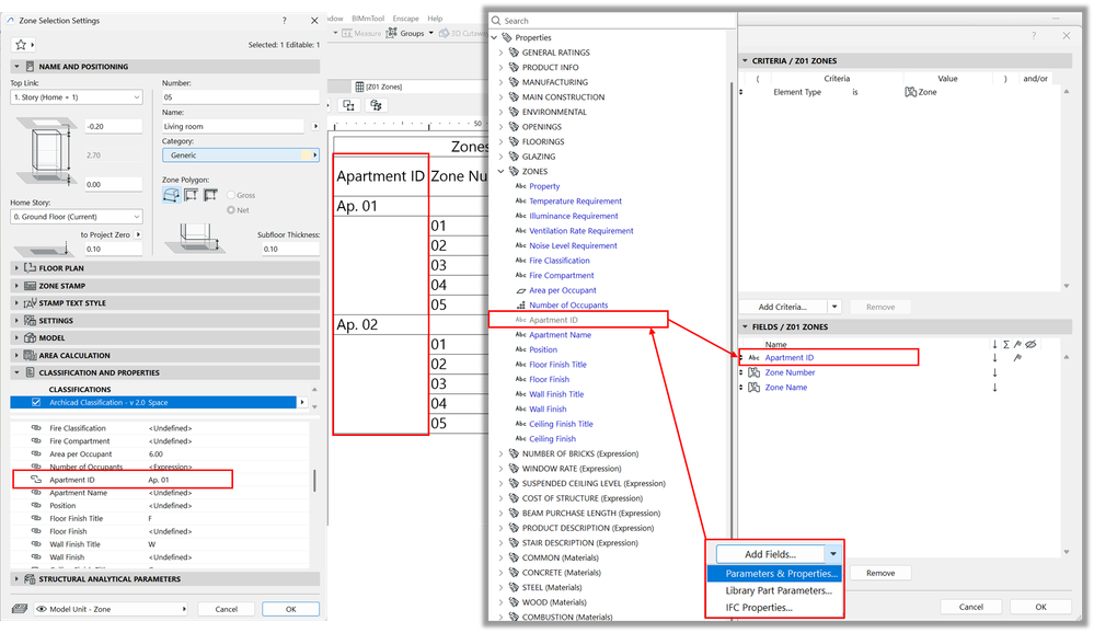

I have been trying to schedule zones within zones without success - does anyone have an idea as to how this can be acheived?
I have a main area zone that covers the entire apartment, and then I have zones in each room. I want to acheive something like this:
Apartment 01
  01 Hallway
  02 Bathroom
  03 Bedroom
  04 Kitchen
  05 Living room
Apartment 02
  01 Hallway
  02 Bedroom
  03 Kitchen
  04 Bathroom
Many thanks!

Hi @CarlM
Try using the Apartment ID within the zone classification and properties and use that for grouping in your schedule.

@CarlM The solution of Ricardo is the good one, but it means that you'll have to give all the info (apartment number and other data -  total sqm area is an other question ) to each of the room. I think that maintaining a 2 systems zone is not optimal.

Hi @CarlM
You can have your area in your schedule too. You just need to group and summarize by your prefered area type field.
You don't need to create a new zone for each apartment, that is what @Mathias Jonathan wants to tell us.

@Ricardo Lopez From what I understand from the initial post, @CarlM has all his appartment info in the global zone (appartment Id for example). The rooms are "independent" from archicad point of view and don't possess specific info .
The fact that the rooms are included geometricaly in the global zone should suffice in this kind of workflow, but I don't think that archicad is capable of that.

Hi @Mathias Jonathan
You are right! There is no way Archicad can have subzones within a larger zone. There should only be one level of hierarchy as zone elements themselves, but properties can be used to group them for scheduling purposes or even creating some sort of graphical override if needed.

Hi @Ricardo Lopez ,
Thank you for pointing out the properties idea. That works great!
Regarding the area the summary of the rooms is not equal to the apartment area since the latter includes all walls within, which the room areas do not. That is the reason - in my way of thinking - that I need the Main zone (apartment) and Sub zones (rooms).
The apartments are listed with other complete "units" such as boiler room, technical room, elevator shaft etc - the Macro perspective.
The breakdown of sub units for the micro perspective.

Hi @CarlM
OK, then you need to create new zones for that "gross" area. Maybe another layer for them could be good.
Anyway there will be no relation between your rooms' areas and those macro ones, so you will need to schedule them separately.
