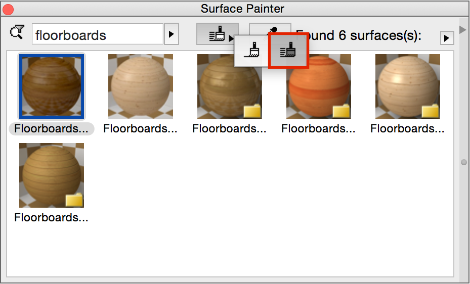

1., Launch the Surface Painter from Document/Creative Imaging/Surface Painter.
2., Select a Surface that will represent the formwork, in this case Floorboards – 01, nevertheless you can also create a new, dedicated surface for this purpose. Search the Surface, pick it up by clicking on it and start painting the different sides of the materials, by clicking them one-by one. Use the Infinite Paint Mode for faster overrides or select multiple elements and use Surface Overrides from the Model panel of the element settings dialogs.
Note: You can select different edges of the slab to be painted, but for example the column will be painted with all its surfaces. This is OK, the Exposed Areas will consider if these faces are visible or not – therefore need formwork or not.
3., Paint only those surfaces that will need formwork.
