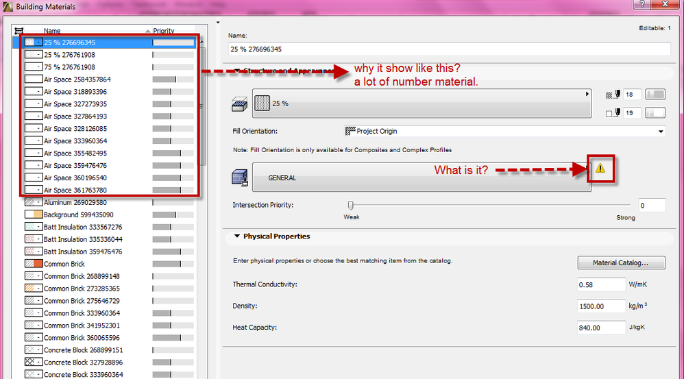

hi.
how to i can use Template V.16 with V.17 ?
i don't see material on V.17
yesterday i could do it but i can't.
Please help me.

Go to the OPTIONS menu > PROJECT PREFERENCES > CONSTRUCTION ELEMENTS and turn off the legacy intersection option.
The yellow triangle means legacy mode is on.
Archicad 17 will automatically create new Building Materials from all of your composites, complex profiles, favourites and default tool settings.
The reason you will have duplicates (Air Space for example) is because you will have used in in many of your composites but with different strengths or pen colours.
So for every unique set of properties it will create a new Building material.
The number after the BM is Archicad's code so the name is different for each BM.
It is somehow based on the properties of the BM (strength & colours).

and question one is how to i know Intersection priority of Material ?
on V.16 have priority a bit but V.17 have to 999.
V.17 Have data for priority of Material ?
or where is can download for data priority material?
Thank you
>> Fon<<
You set the priority to what you think it should be.
There aren't any set values.
In 16 there was a priority from 1 to 16.
Now in 17 the priority goes from 1 to 999 so you have a lot more flexibility.
When you convert from 16 to 17 it will automatically set the new priority to an equivalent value on the new scale.
These new priorities work with the new "junctions" in 17 so that now even in 3D and section your composites (walls, slabs, etc.) will all trim their skins based on these priorities.
This is with legacy mode turned off.
If legacy mode is on (i.e. same as it was in 16) then you will find in the tool settings there is a "Junction Order" that you can use based on the old 1 to 16 scale.
