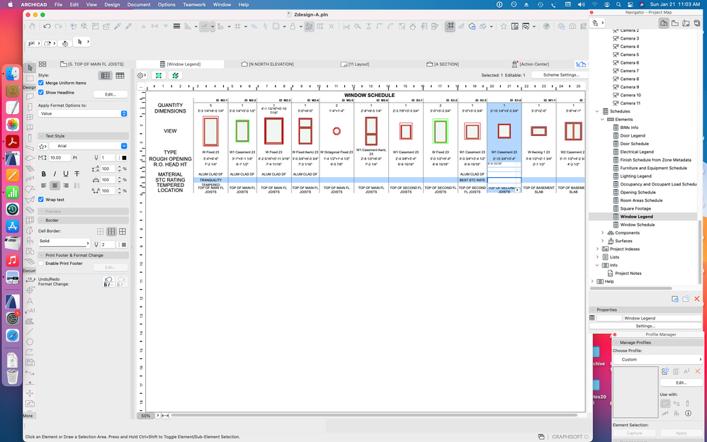

AR23, macOS 10.6, In the window legend, under schedules, the editable fields are no longer editable. When I set up the legend I placed 5 editable fields (ones in which I could add the information) and now for some reason I can no longer edit them. Removing what is written is allowed but adding words is no longer possible. Changing the window sizes and types in the floor plans still edits the legend. Any suggestions?

Screen shot #1: Window Legend is open

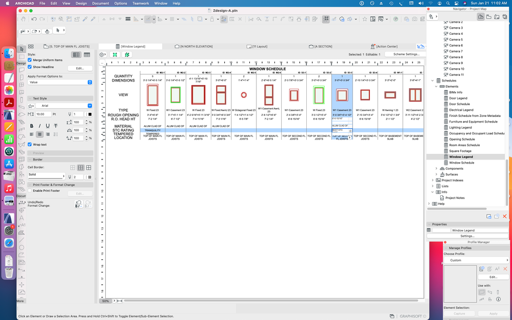

Screen shot #2: The column with the Item ID S3-3 editable row titled STC RATING is highlighted to edit

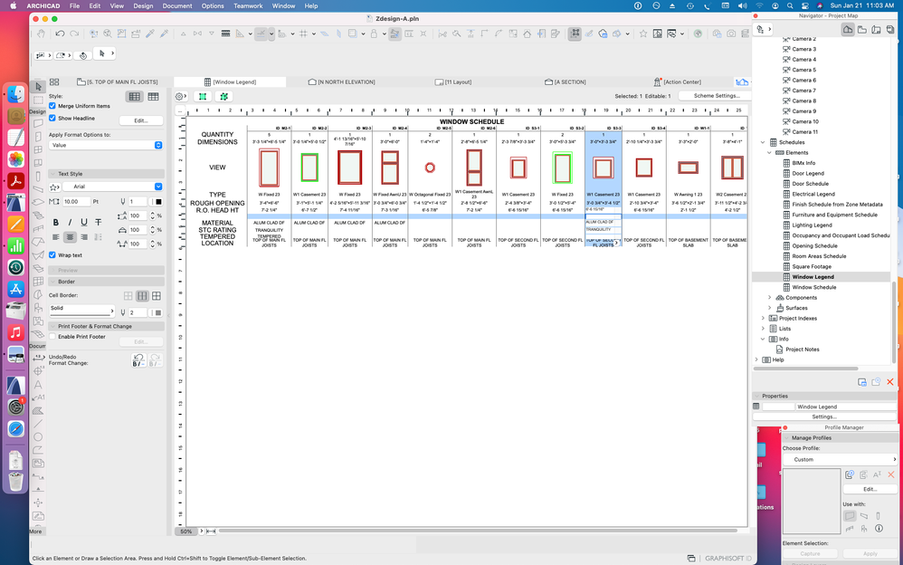

Screen Shot #3: The words BEST STC RATING are replaced with TRANQUILITY

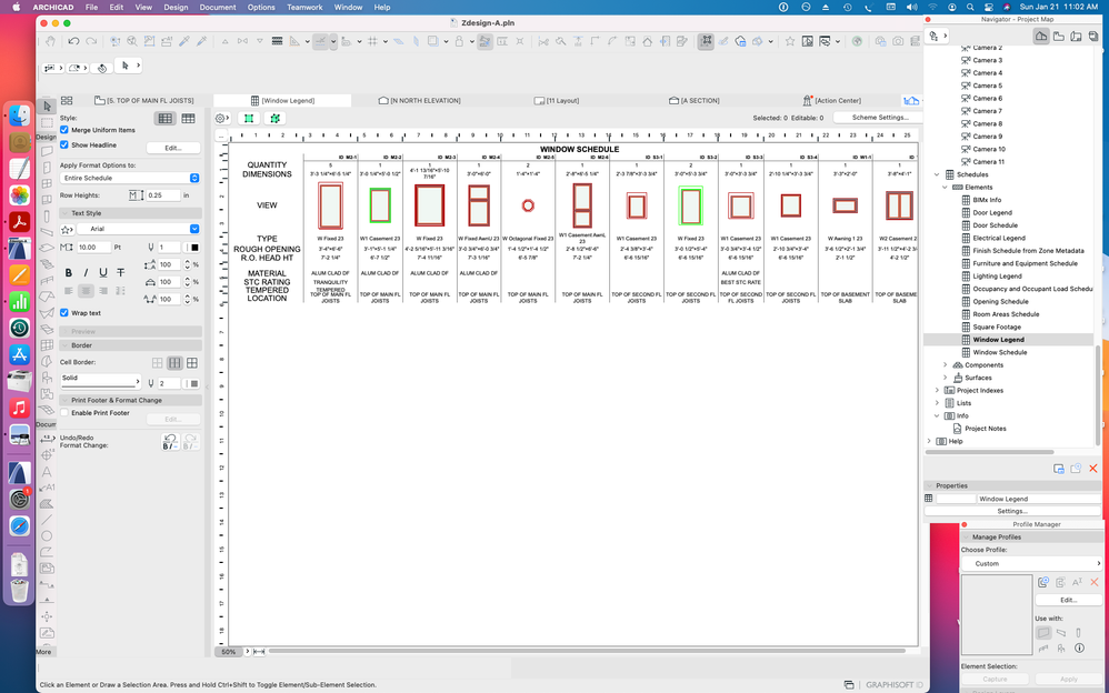

Screen Shot #4: The editable row above the edited one is highlighted showing the change has occurred

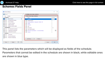

Hi @Quirk,
I guess you may find the answer for your question in this Screenshot.
AC 28 INT 3110/WIN 11
Mahmoud,
I don't understand. In the first column I was able to edit 8th row without a problem, In the ninth column I was unable to edit the 8th row. If the row is editable in the first column why is it not editable in the 9th?
