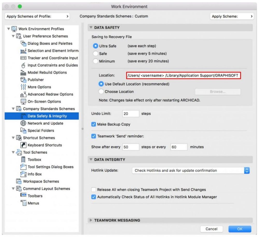

  7. If the Autosave folder is stored in different location determine by looking in the Work Environment (Data Safety & Integrity). Rename it first then handle it as mentioned above. It is recommended to use the Default Location.

  3. Create a new or format an existing partition to HFS+ (OS X Extended - Journaled) - Partition size: ~ 20 Gb or more -
  4. Open Archicad and in the Work Environment redirect the following paths to the HFS+ partition: - Data Safety (Saving to Recovery File) - Special Folders (Temporary Folder, Cache Folder, Template Folder)
  5. Close and restart Archicad to enable the modifications
