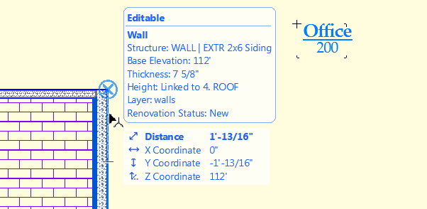

Hey all, my AC21 is very fuzzy visually and has some other visual anomalies. I can have 16, 19, and/or 20 running and switch back and forth for comparison, and it's only 21 that's an issue. (16/19/20 are all crystal clear, no problems.)
It's mostly the mouse icons that are the problem. I've attached a screenshot-- it's almost like there are visible nodes in the mercedes and the arrow.
The lines all tend to distort as well-- there's no consistency to the lineweight on screen no matter what the pen, element, or fill pattern is.
Another issue which may or may not be related is that any text that is not left-aligned skews way off to the right on-screen. It does print fine but falls largely outside of the text box on-screen. (You can see this in the 21 screen shot too.)
Any thoughts on how to fix this/these??
In case it matters-- running a ~6 month old Dell Precision 7510 laptop with dual monitors, Nvidia Quadro M2000M v376.54, Intel Xeon 3ghz, 64-bit, with Windows 7 Pro+SP1.

I faced the same issues on win 7, brand new dell precision desktop.
I solved part of the issues increasing the hardware acceleration
AC 19 and AC21 latest hotfix
Win 10 Pro 64bit
Double XEON 14 CORES (tot 28 physical cores)
32GB RAM - SSD 256GB - Nvidia Quadro K620
Display DELL 25'' 2560x1440
