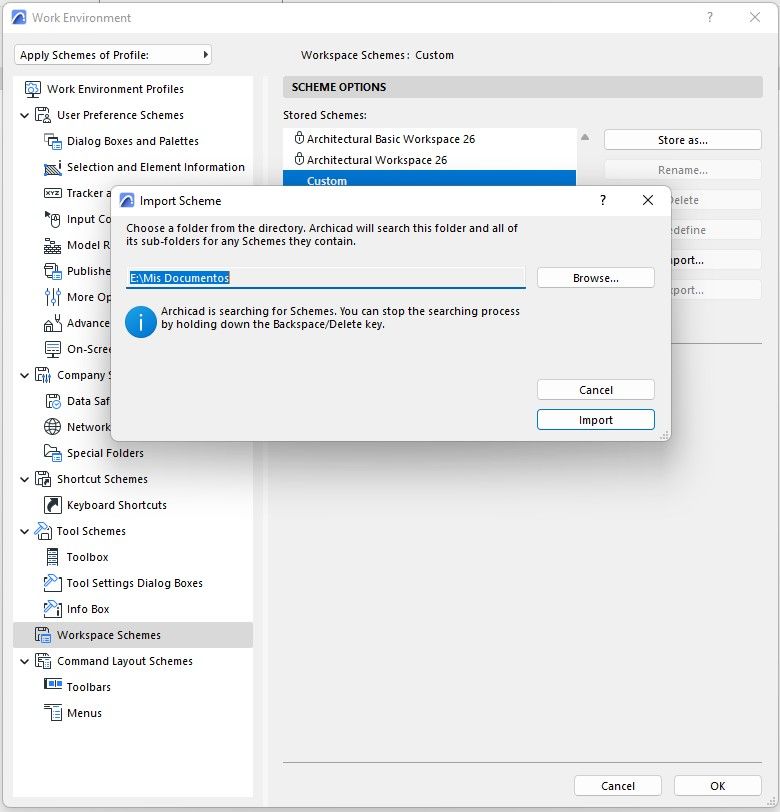

Archicad 26 freezes in the window "Import Scheme" (XML files) such as: Tool Schemes, Workspace Schemes, Command Layout Schemes, forcing me to close AC26.

Were the schemes created in an earlier Archicad version?
If yes I would suggest trying the following method and see if it solves the issue.
The workflow to convert XML schemas between versions is to:
- open a plan in the version where the scheme was created
- import the scheme
- save the file
- open the file in the required Archicad version
- export the schemes.
I hope this helps you deal with the problem.
If it is not relevant I advise reaching out to your local support with a detail description about the issue.
Kind regards,
Dani Benjamin
Technical Support Engineer
Thanks for answering, the problem arises when I press the "import" button, it freezes, I don't even have a chance to search the folders on my PC. I will contact the local technical service. Thanks.
