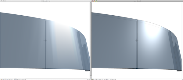

Part of the slowness in ArchiCAD 14 may occur from the advanced model illumination employed in ArchiCAD 14. ArchiCAD 14 now uses Per-Pixel Lighting which gives a much more realistic result. (see image below - on the left is ArchiCAD 13, on the right is ArchiCAD 14) This feature does need more video card power, but according to our tests it causes a slowdown of 20-30% which should not be noticeable if your card is powerful enough. (as long as the frame per sec rate is above 30, you can not really see a speed difference).

gkmethy wrote:
....Per-pixel_lighting]Per-Pixel Lighting which gives a much more realistic result....
Thanks for the heads up Gergely.
At least I'm getting something for it, so it's a good thing for me I guess.
On my new machine I don't think it's 20-30% slower,(but maybe 5-10%?), but for those who have yet to upgrade that might be the case.
Maybe for those who can't upgrade right now, the answer might be a switch to turn it off for those who can't upgrade just yet?
Yes, thank you very much for the reply Gergely. I did notice that the lighting was somewhat different in version 14. I went to adjust my frame per sec rate under the OpenGL Options, but oddly it will only allow me to enter 25 as a maximum... If I type 30 or more, it just reverts the number to 25. Is this because of a limitation of my Graphics Card, or is it some kind of bug?
I did, by the way, notice an improvement when I adjusted it to 25 from the original setting of 10. It is, however, still "clunky." Also, I did throw 2 more gigs of memory into the computer (effectively 3.25 gigs under XP), and it made no difference whatsoever.
