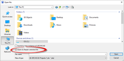

Are you using Macs by any chance?
There was a known bug where 25 will crash when closing a window in the TAB bar.
https://community.graphisoft.com/t5/Setup-License-forum/Archicad-crashes-on-macOS-12-3-when-closing-...
It has been fixed with update 5010, so make sure you are up to date.
Otherwise I would try opening the file with the repair option.
Open the file trough the FILE menu in Archicad and you will see the 'Open & Repair' option.
Versions 6.5 to 25
Dell Precision 3510 - i7 6820HQ @ 2.70GHz, 16GB RAM, AMD FirePro W5130M, Windows 10
Solution
@yasmine_s29 wrote:
Then I have tried to open the file as you have suggested with the 'Open & Repair' option, but it says that the file is already opened by the same user and if I want to proceed as Read-Only.
The '.LCK' file has not been deleted, so it thinks the file is already open.
You can delete that file - it will be in the same folder as the .PLN.
Or open as read only and then 'Save As' with a new name.
Which may not be a bad thing if you are having trouble with a file.
It never hurts to have more copies.
If you ever get to fix the problem and you are happy with the current file, you can then delete all of the old ones.

We are all using Windows 10.
I forgot to mention that when I try to close the file, the regular window pops up whether I want to save the changes or not, I click YES and then Archicad crashes.
Solution
Versions 6.5 to 25
yasmine_s29
Genius!!! It worked. Thank you so much for the support Barry, the file works perfectly fine now.
