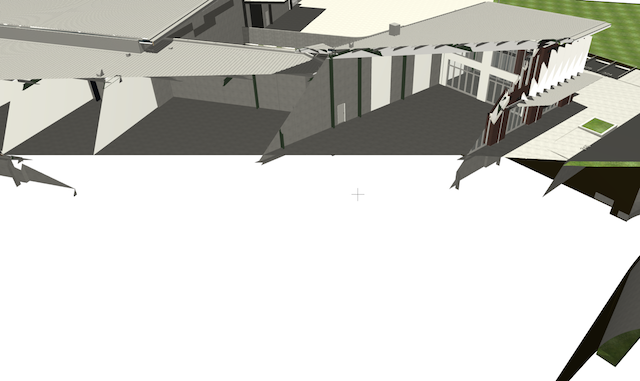

In the 3D window, if a largish Archicad 16 model, I am having a major issue where if I have just the right sized marquee, I can make my model disappear partially with a live cut plane. If the marquee is smaller, then no problems, the model is fine, if the marquee is bigger, no model at all.
I have the latest build of Lion, latest AC16 build, a 1GIG graphics card (of note it is even worse on a 1/2 GIG graphics card.
Below are some images of what is happening.
Anyone else ahd the issue, or got any ideas to work around?
I ahve also manually turned antianalysing on, but tried on a machine without the antianalising on and got the same result.

Karl Barker
More views:

David Maudlin
Karl:
This looks like the bug described here:
Bugs/Model cut in 3D
HTH
David
