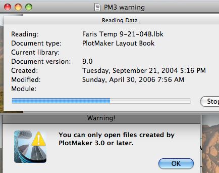

Laszlo, thanks for your clear thinking, but there is still an issue. I have tried this using 12 (and 10 & 11 as well) with the same results:
I open a LBK file created in version 9, which I recall used Plotmaker 3.0 or 3.1. The file opens fine, however I am unable to re-link the PMK drawing files (using the 'Read From' button in the initial missing source warning dialog box), and get the warning message 'You can only open Plotmaker files created in 3.0 or later.' I believed I had to convert to project based files first requiring the need to employ AC9 (which I am unable to load on my MacTel workstation from the commercial AC disc as described in my earlier post).
Also as you point out, PMKs are back in 12, so why wouldn’t they be re-linkable there without the need to convert to be project based?
Thank you for any additional comments. Scott

ArchiCAD 9 had PlotMaker 9 as its companion.
Try opening the LBK in PlotMaker 9 and save it (maybe you already have done that).
Also, open in ArchiCAD 9 the old project from which the PMK files were saved. Then resave those PMK files to make sure all PMKs are also version 9.
Then try opening the whole lot in 12.
I hope that solves it for you.

Laszlo, thanks again for your quick help. I would like to open these files in AC/PM9, however the software is unable to load on a MacTel workstation. Please see the loading error screenshots in my earlier post.
There was a similar issue with AC10 and the commercial disc, where GS later provided a separate download for the MacTel version of AC10. See: http://tr.graphisoftus.com/ and go to ArchiCAD10 where you will find the Mac Intel Based AC10 version for download. I cannot find the equivalent download for AC9. I am hoping there is an answer for the MacTel environment.
So in summary, AC/PM9 is unable to load on a MacTel workstation from a commercial disc, and AC12 will not recognize PMKs created in PM9. I need to resurrect two version 9 projects and am stuck at the moment.
Thanks again, Scott

I don't think Archicad 9 can run on a MacIntel. I seem to remember that from when AC10 MacIntel version was released.
Sending the installer would not help any.
