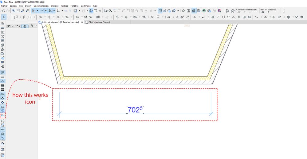

cotation
abdelaziz
how this works icon selection

The title isn't clear from your post, but I can see from the picture you're looking at On-screen view options. There is a new option to only show Dimension Text, therefore this option allows you to see its non-printing line. Like other on-screen view options.
More info here:
http://helpcenter.graphisoft.com/guides/archicad-20/archicad-20-reference-guide/user_interface_refer...
